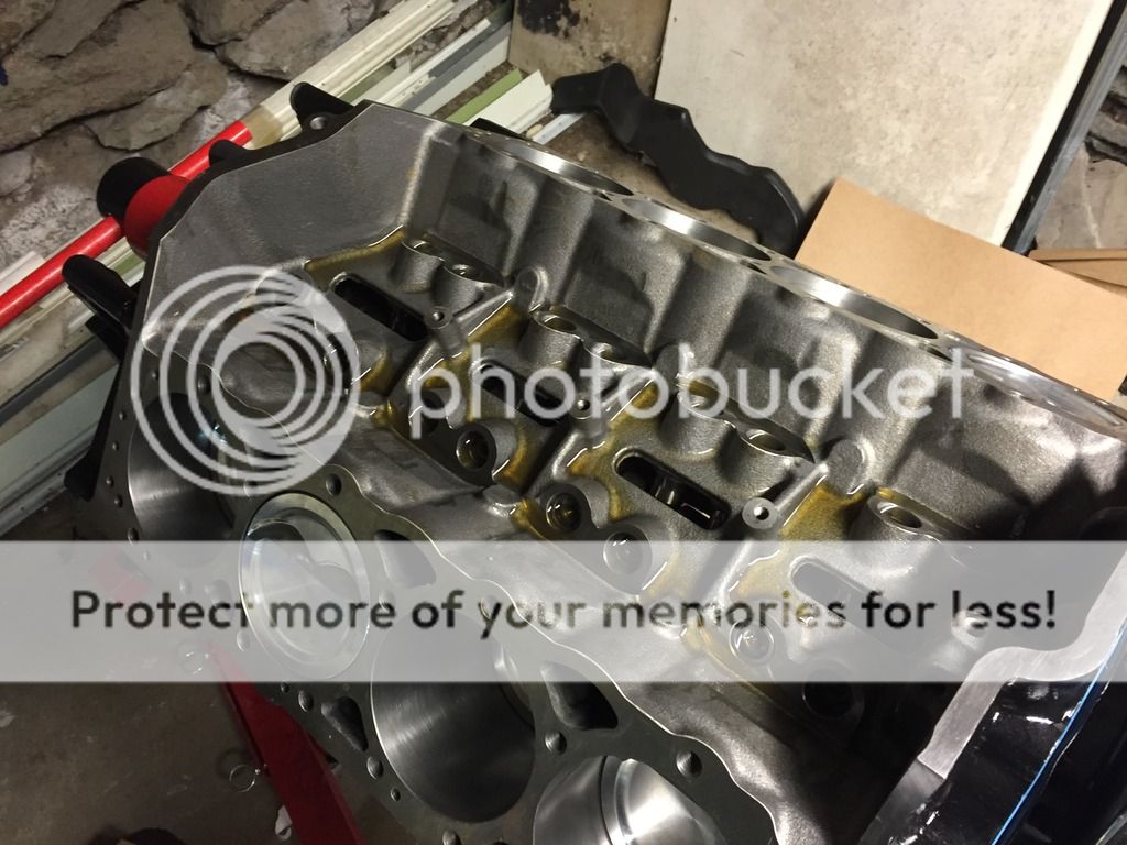

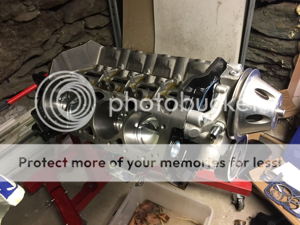

This winter I am rebuilding my engine, as I went to a engine shop to bore my old block and they found a crack. So I went to summit and bought a Dart SHP block instead. It has been fitted with a Scat rotating assembly kit, and will have a Trick Flow top-end kit, along with a Weiand 144 Supercharger and a 100HP shot of NOS.
The engine consists of:
- Dart SHP 31161111 block
- Scat Premium Pro Sport Forged 4340 H-Beam Connecting Rods with ARP 8740 7/16'' Cap Bolts
- Scat Crankshaft - 4340 Forged Standard Weight Crankshaft
- Premium Forged Pistons with Piston Rings -16.2cc dish
- Summit Racing SES-3-60-08-001 Oil pump
- Canton Racing Drag Racing Wet Sump Oil Pans 13-104
- ARP Main Studs
- Centerforce DFX Clutch Kits 01735552
- RAM Billet Aluminum Flywheels 2501
- Trick Flow® Super 23® 195 Cylinder Heads for Small Block Chevrolet TFS-30410013-M72
- Trick Flow® Roller Rocker Arms TFS-31400510
- Trick Flow® Hydraulic Lifters and Lash Adjusters TFS-2140000
- Trick Flow® Track Max® Camshafts for Small Block Chevrolet TFS-31401001
- Trick Flow® Billet Steel Timing Sets TFS-31478500
- ATI Standard Harmonic Balancers 917781
- Weiand 144 Pro Street Supercharger 7750-1
- EMP Stewart Stage 4 Water Pumps 42203
- ARP Head Bolts
- Holley 750CFM Mechanical secondaries
- NOS 05101 - NOS Super Powershot Nitrous Systems
- Muncie M21 Gearbox
- MSD Distributor
- MSD Ignition box
- Custom Headers
- MSD Starter

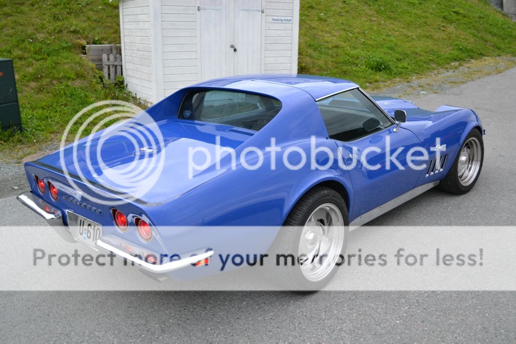

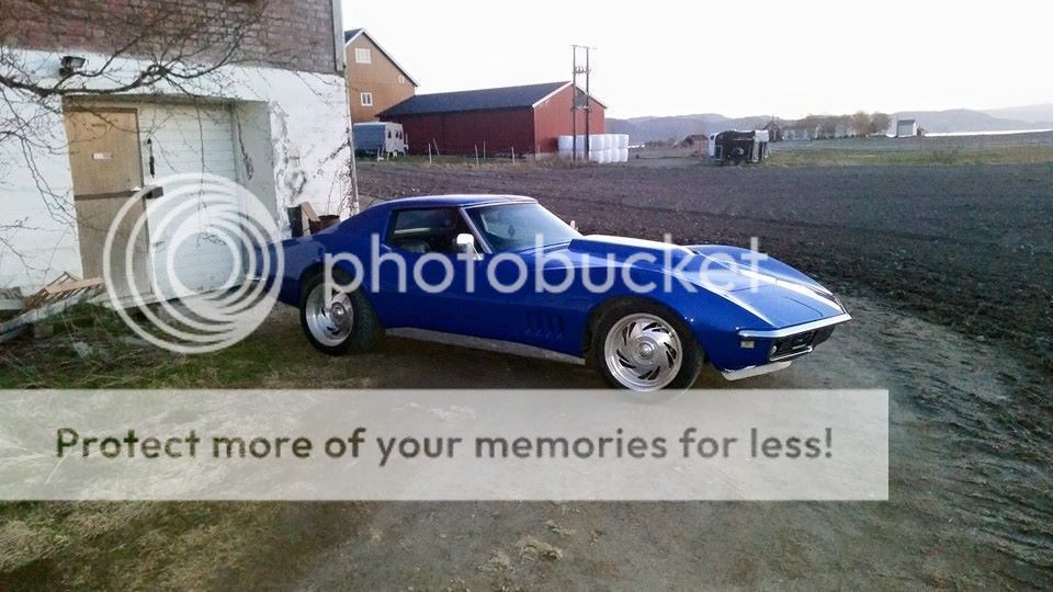

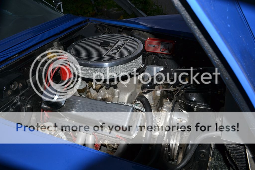

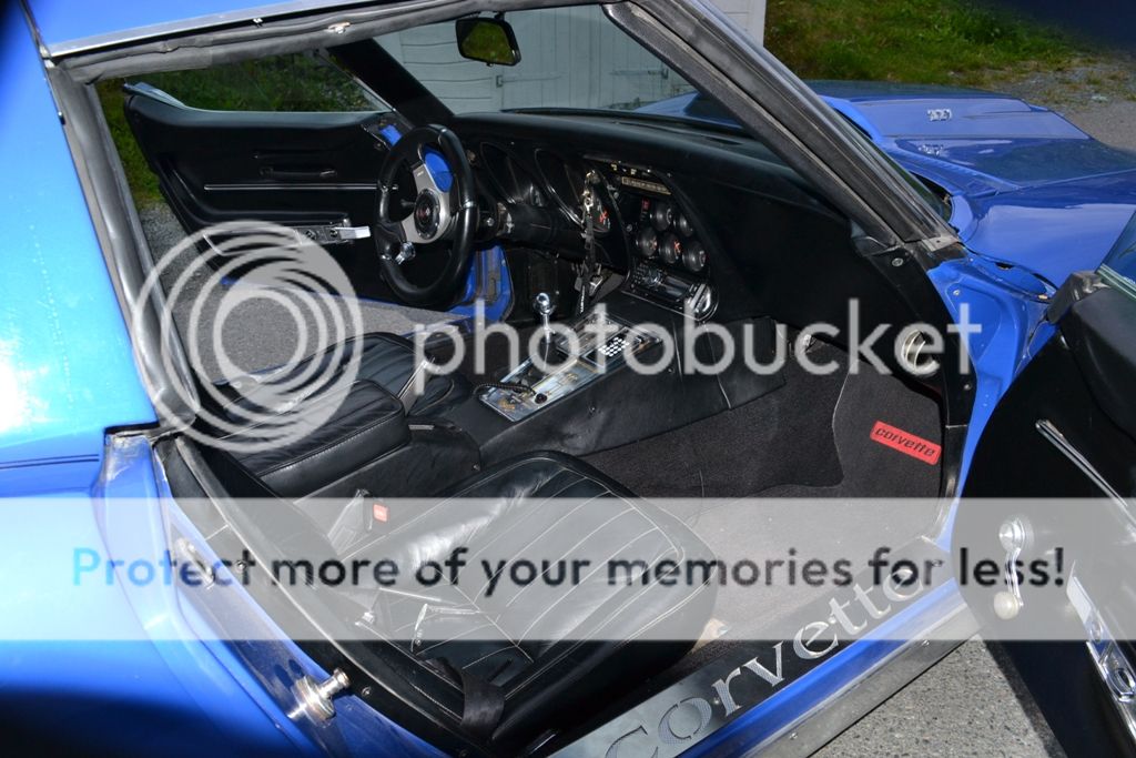

But lets go a few steps back first. I bought this car at Autumn 2014. It was an allright car, but I found a few things I would like to fix. So here is what happened last winter:
At the time I bought the car it looked like this

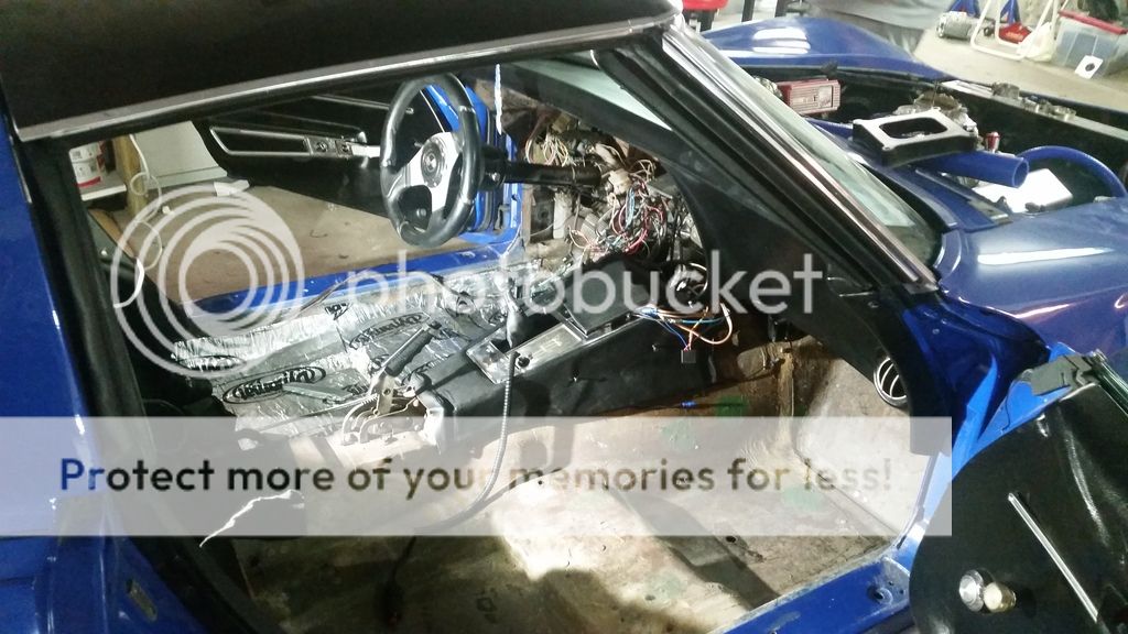

The first thing I got to experience was that the roof was not rain proof anymore, and I got some water in the coupe. I had to strip the interior to dry it, and took the advantage of putting in some dynamats while I had it all out

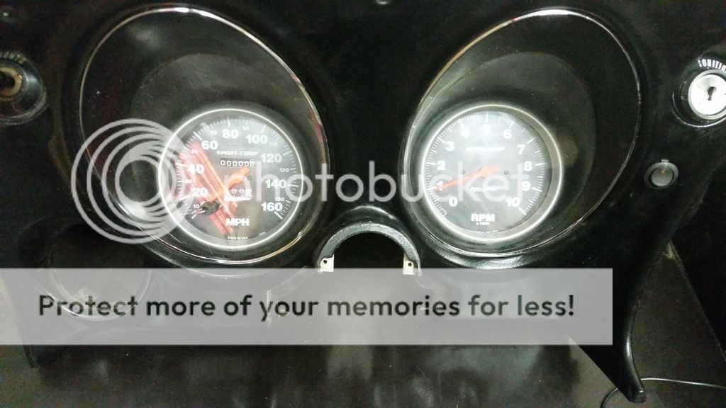

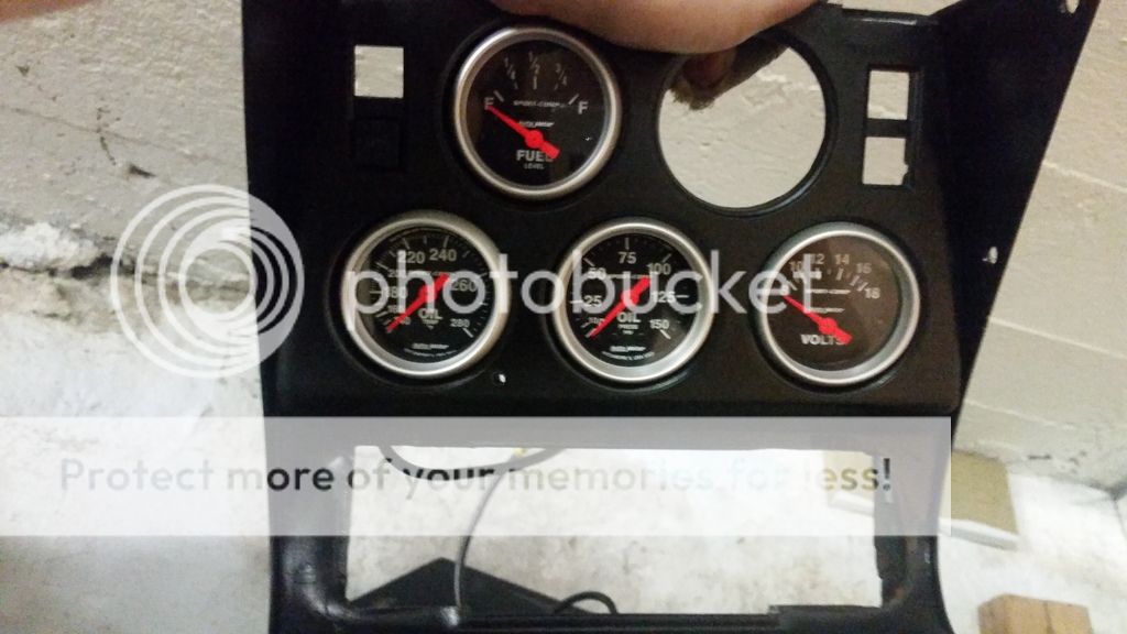

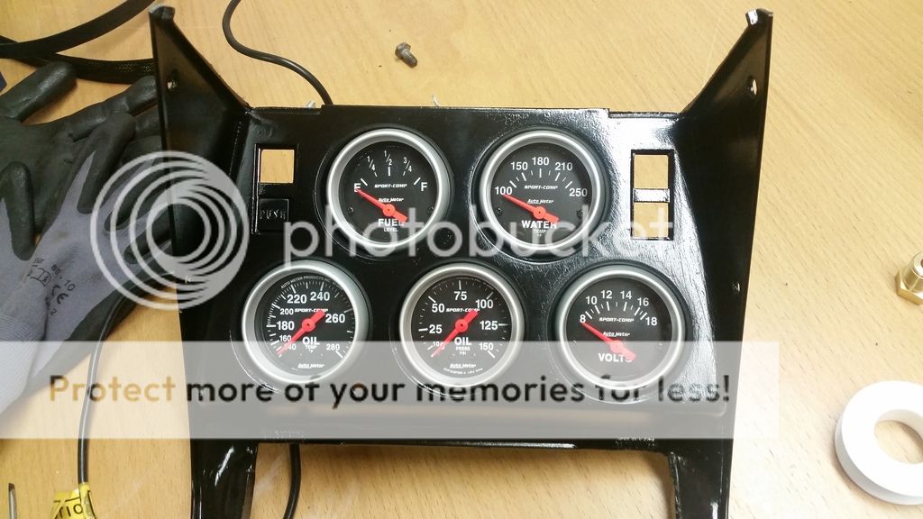

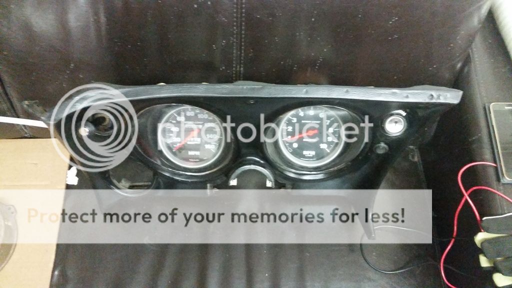

Some instruments was also out of order, so I ordered all new Auto Meter instruments instead.

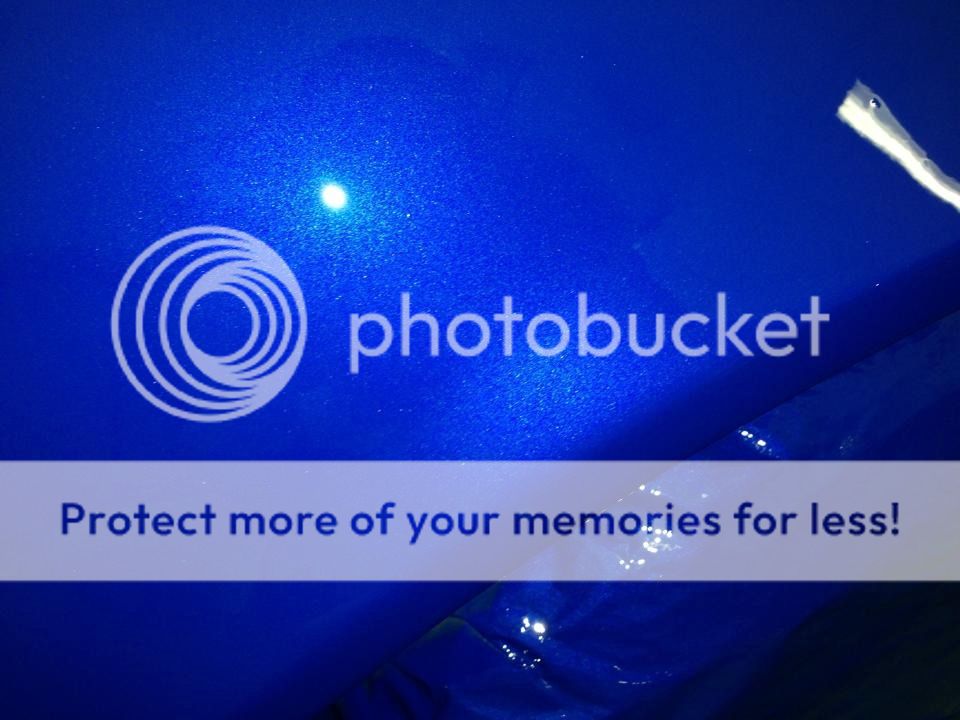

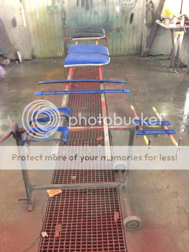

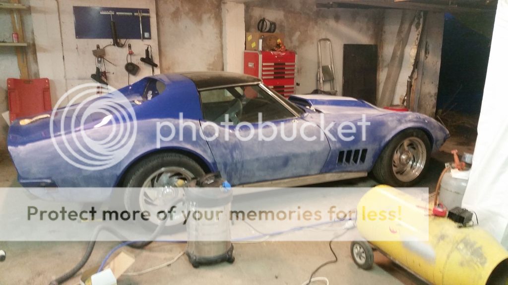

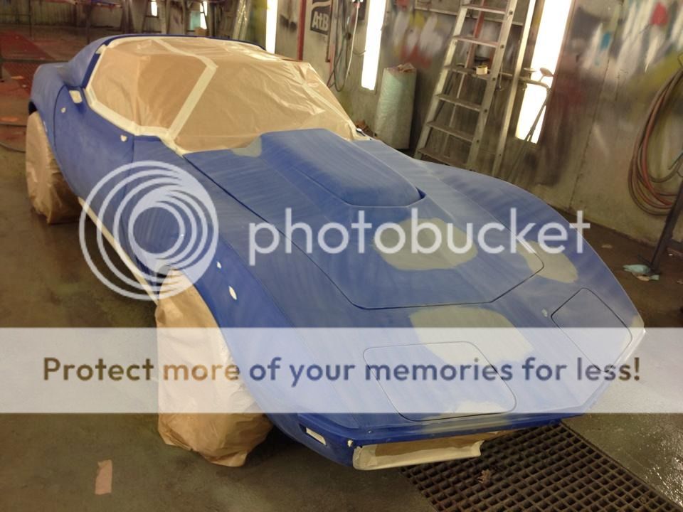

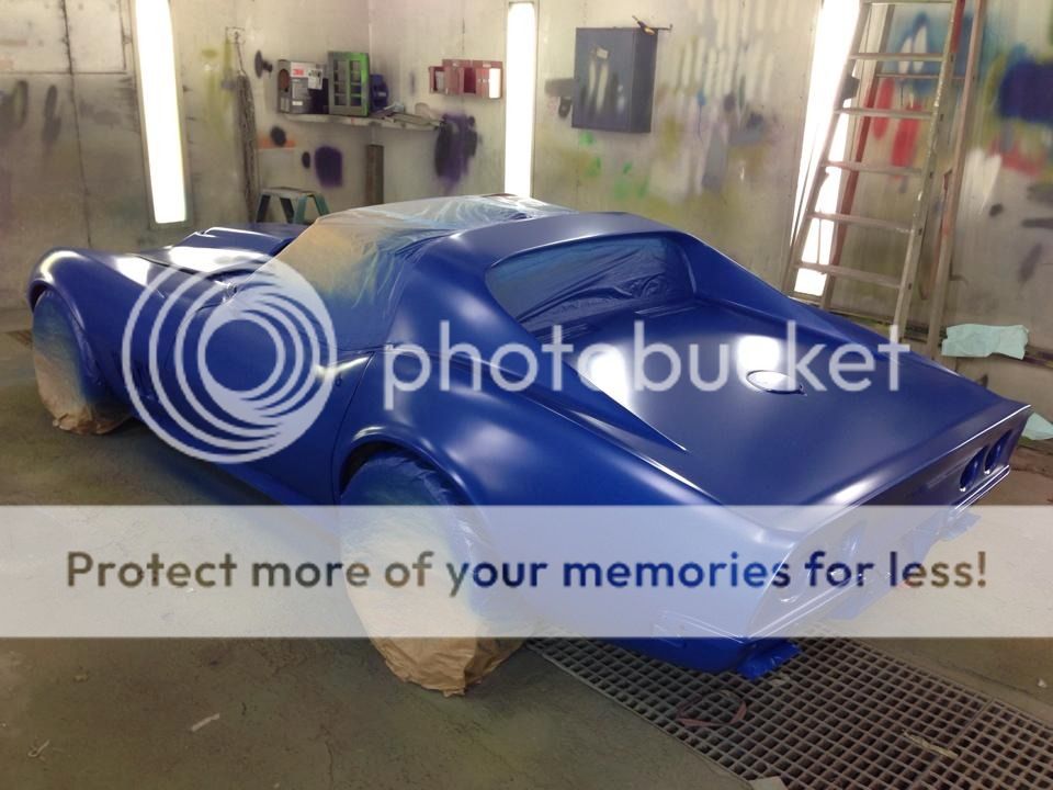

April had come, and I was becoming real exited to get out and trying my rebuilt engine. However, a friend of mine somehow convinced me to repaint my car. He would do it for a price I just couldnt turn down. And there were some real issues with the paint. So.. we started grinding it down.

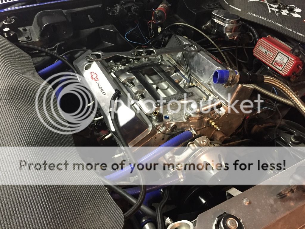

EDIT: (I forgoft about when I fitted the supercharger).

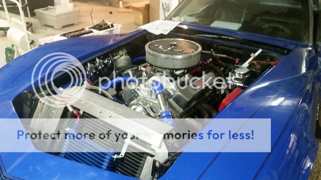

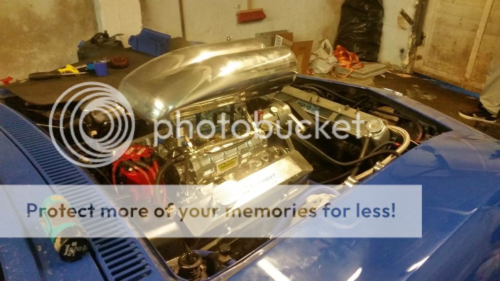

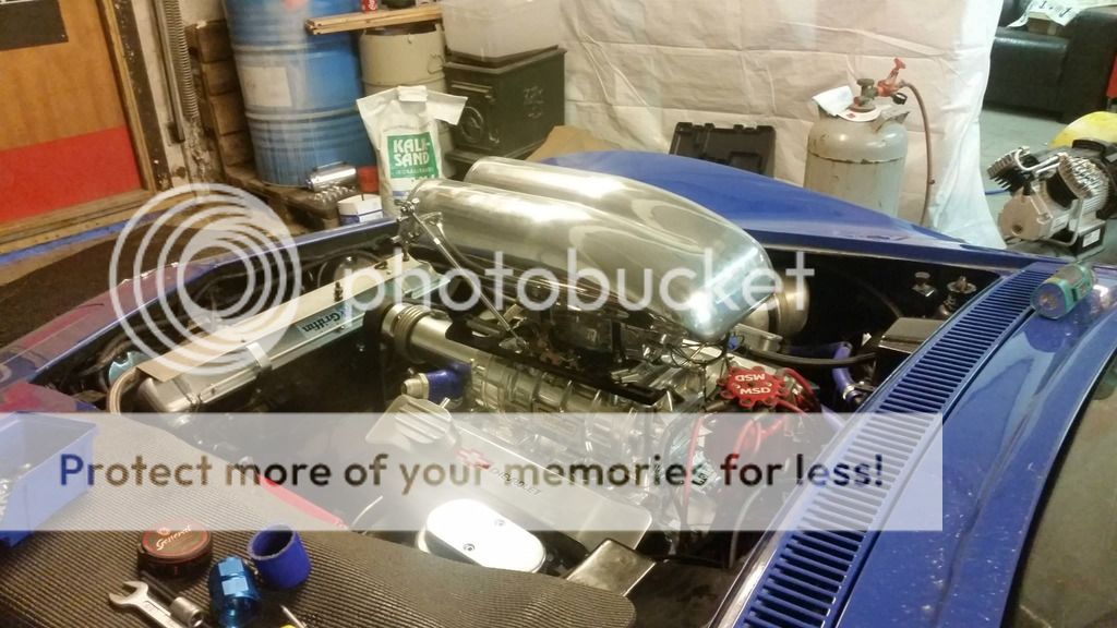

When returning from my Road Trip I had had some ups and downs. Had to fix some leaks, specially one between the block and the intake. So I figured, when the Intake first was off, why not fit my supercharger. So I did.

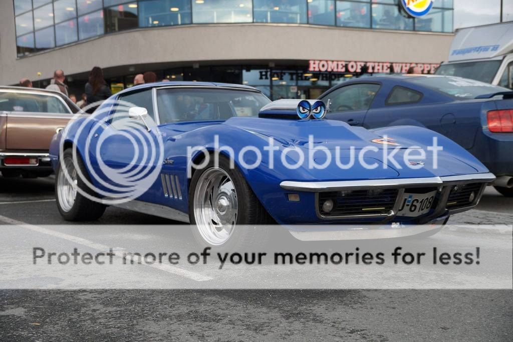

After this I attended a drag race. Didnt change my tires, so I had no grip and didnt get any good times. we run 1/8 mile drag races, and my best was at 9 seconds. Propably had wheel spin the first 70-80 meters before I got any grip at all. However, I had oil overpressure in the engine and oil spilled everywhere. So when fall came again, I had decided to make a 383 stroker of it. This is where I started this thread. The block was cracked, and all of the piston rings were fried. The engine had seen its better days.

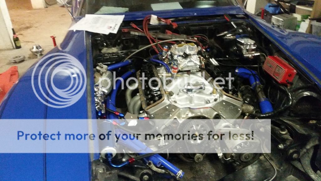

So this is where I am now:

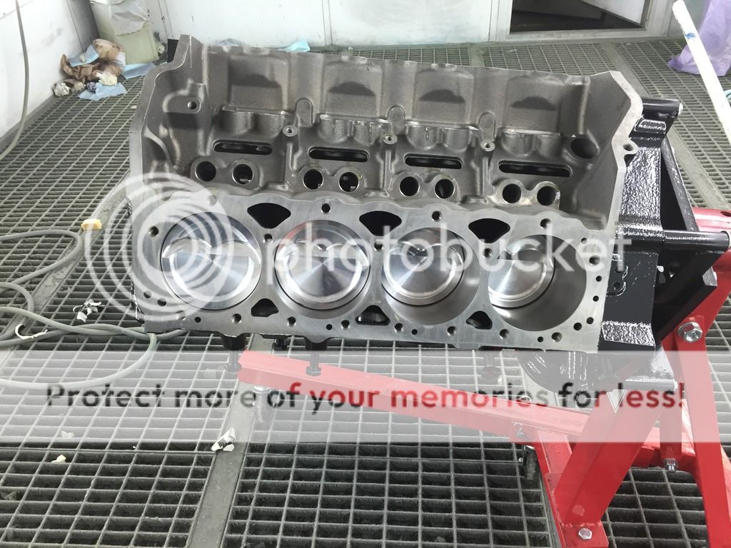

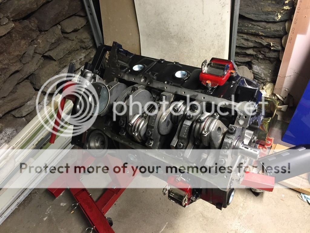

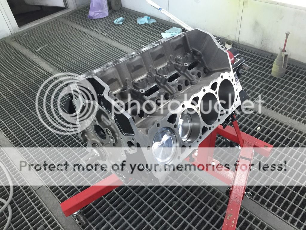

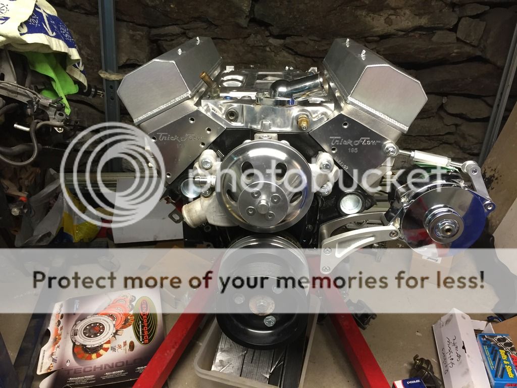

Right now we're working on putting the engine together. Waiting on a few parts. And then Ill turn it over to a local engine shop who will put it on a dyno and adjust it. Ill get back with more information when that has been done.

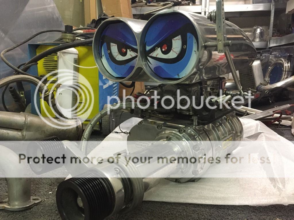

Når jeg monterte pressa hadde jeg allerede bygd om toppen av motoren med Trick Flow 195cc topper, Kvassere kam, roller rockers med mer. Denne kammen gjorde at bilen hadde en skikkelig grom tomgang, men også at jeg sleit litt med gasspådrag under 2500 omdreininger. Da gikk den urent og harket litt, men med en gang jeg passerte 2500 så dro den som bare juling. Pressa sørget for at tomgangen jevnet seg ut en god del, og ga meg de kreftene jeg manglet i bunndraget som også gjorde at jeg fikk en enorm gassrespons, også under 2500 omdreininger.
Bilen ble ufattelig artig å kjøre, selv om jeg sikkert hadde en god del effekttap på grunn av overtrykk. Derfor har jeg i vinter byttet både blokk, stempel, råder og veiv blant annet.
Jeg ville heller ikke kutte i panseret på bilen, hovedsaklig fordi jeg var veldig usikker på hvordan politi / biltilsyn ville se på dette.
Derfor gikk jeg til anskaffelse av et ekstra panser. Vi satte pressa på motoren og monterte scoopet. Deretter satte vi panseret på bilen, og startet å kutte. Vi startet med et lite kutt, og målte oss utover. Vi kuttet sikkert 5-6 ganger før vi kom til den endelige åpningen.
Med Weiand 144, NOS-plate mellom gasser og superchargeren og en Holley-gasser ble klareringa akkurat 0cm mellom dette scoopet jeg valgte meg og toppen på panseret.
Dette var noe jeg siktet etter. Jeg ville ikke ha unødig mye over panseret, og valgte derfor å finne meg et likt som jeg hadde (L88 de heter?).
Installering av gasser var null stress. Bytte innsugsmanifold, sette på pressa og sette på gasseren igjen. Man må selvfølgelig også sette på et reimhjul frempå svingningsdemperen, men det var ikke noe problem da det er så god plass i disse motorrommene. Likevel var det ekstremt vanskelig å få på reima på reimhjulet nederst, da klareringa mellom hjulet og traversen er noe slik som 3-5 millimeter. Så å få på et større reimhjul blir umulig uten å modifisere traversen. Noe som er litt synd siden jeg kunne tenkt meg å gjort det for å øke psi med 3-4 nå som motoren blir bygget om.
Skulle man få seg en fin bonus på jobben og ikke har noe annet å bruke det på, vil jeg absolutt anbefale en weiand-presse. Det koster litt, men det smaker også.

Motoren ble bygget sammen, og vi fikk tak i 4 mann for å få monsteret av en maskinist nedi motorrommet. Dette er en bil med manuell girkasse, så det skulle vise seg å bli både trangt, tungt og ****. Det endte med at en nordlening klemte ut av seg glosen "Klare æ d nu, så ska æ flir" i det han vippa motoren inn på kassa mens han sto kalvbeint over den oppi motorrommet.
